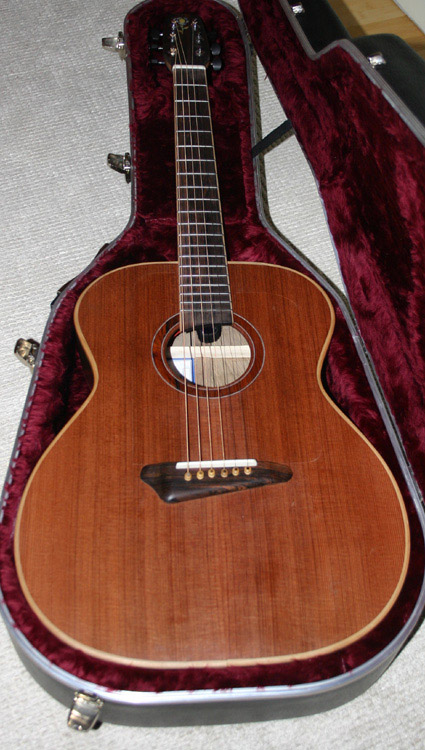

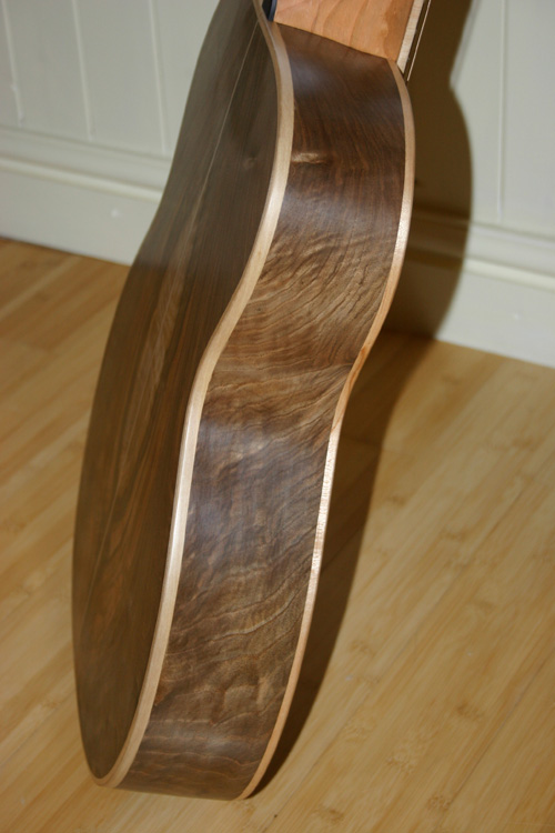

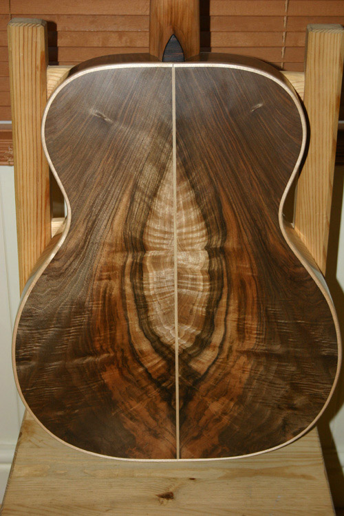

Peter here is one in European I completed recently, this one has a redwood top.
This one is European Walnut rather than the american black walnut.

Boy, she sure is a beauty!! What a gourgeous back/sides set!

PostPosted: Thu Feb 09, 2006 1:28 pm
Posts: 952
Russell
That is incredable!!!!
PostPosted: Thu Feb 09, 2006 2:50 pm
Yup, Russ, everytime you post that I start drooling.
Were it not that I feel solicitous for my keyboard, I'd say post that picture regularly.
PostPosted: Thu Feb 09, 2006 3:17 pm
Yep, once again Russell, she's a killer!
PostPosted: Thu Feb 09, 2006 3:22 pm
Russ,
Whoa! After ordering, I'm even happier now, though I won't have anything as nice as yours to show for it
PostPosted: Thu Feb 09, 2006 10:37 pm
Russell that is one gorgeous set of walnut. Beautiful looking guitar.
